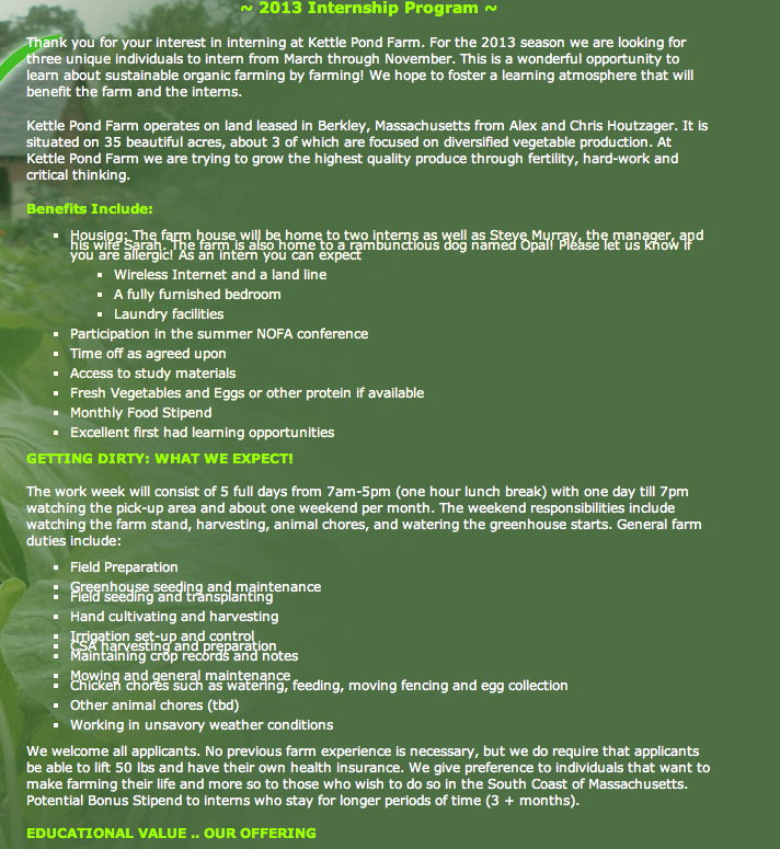

Thanks for the info. I created a style for my bullets but they are a little erratic when viewing in a browser. They look fine in FW though. Any ideas? I just used a 75% leading.
Leading controls the relationship between text within a single tag. A list is a nested tag: UL on the outside and LI for each bullet on the inside. Your style rule has to cover the space between LIs, not the leading within those LIs. Remove the leading (line-height in proper CSS terms) and replace that with Space before (margin-top) and Space after (margin-bottom). Make both of those read the same (margins collapse into one another – a 12px margin on both the bottom of one tag and the top of the next will not result in 24 pixels between the two, but rather just 12 pixels).
http://www.intuitionusa.com/1/leading.png
Thanks for the help. However, I am trying to go the route of letting Freeway handle the coding while i use the Freeway interface in order to be faster. I want to just use Freeway’s tools on lists.
You still need to create styles that respect the code that Freeway will generate.
Leading (or line-height) is for within a tag, like the inter-line spacing inside a paragraph. List items are like whole paragraphs themselves, nested inside a larger container called a UL or OL (unordered or ordered list, respectively). Therefore you have to use Space Before and Space After, because you are trying to control the space BETWEEN tags, not WITHIN them.
Open up the Edit Styles dialog and create a new style with the name MyList. In the Paragraph Styles section of the interface, click the (+) button and choose Space Before. Set this to some small amount, like 4px. Do the same for Space After. Close the style editor, and select your entire bulleted list. Click once on the MyList style in the Styles palette.
