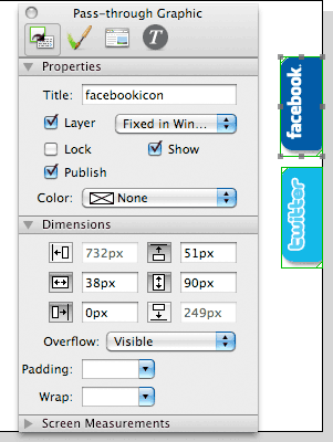

Anyone got a method to have a button or buttons stick to the browser edge like this example for facebook/twitter buttons:
Fixed in Window in the Position picker of the Inspector, coupled with setting the dimension fields like this:
Notice that the distance from the right is set to zero, and the distance from the left is disabled. (You can tell because its icon is grayed back, and also because you will not be able to select or change the number inside it.) You disable the distance from left by clicking on the distance from right icon.
THANKS very much Walter!
I will give it at try.
That worked just fine!
Thanks Walter
