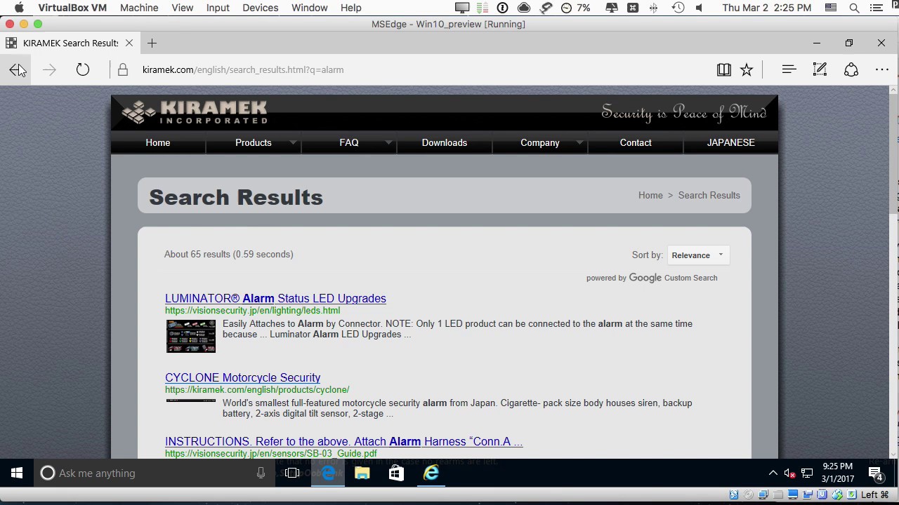

Walter,
The border just acts as a hover state to highlight the search field. I set that border in the CSS. The only reason I use JS to kill it is because when I view the search results page and then click the browser back button, the border displays and continues to display even if I am not hovering over the search field. My JS prevents that problem from happening.
By the way, I just now began testing IE and Edge. Without the “window.onload” of my original JS code, clicking the browser BACK button from the Search Results page will leave the search term inside the search field. But when I use “window.onload”, that problem goes away (the search field properly gets blanked). I tried putting the JS just before but the problem remains. Without “window.onload” search terms get stuck in the field when using modern IE or Edge. No other browser, not even Safari in iOS, needs “window.onload” – they clear the search term without it.
–James W.
dynamo mailing list
This test page uses “window.onload” before and works great in any browser, including stupid IE11 and Edge (but of course, it conflicts with Freeway rollovers that put “onload” in the “body” tag):
https://kiramek.com/search-test2.html
This version eliminates “window.onload” and puts all the JS before , but IE11 and Edge retain the search-term inside the search field when you click the browser BACK button on the Search Results page:
https://kiramek.com/search-test3.html
To test the above pages, just click inside the search field and type “alarm” and then hit return.
–James W.
P.S. If you don’t have a Windoze computer, just download the free VM from MS here:
https://developer.microsoft.com/en-us/microsoft-edge/tools/vms/
I tested with “MS Edge on Win10 Stable” on “VirtualBox.” I also tested on a real Win10 computer and saw it respond the same. The VM comes with Edge and IE11, by the way.
dynamo mailing list
Here’s a screencast showing the problem (no sound):
James W.
dynamo mailing list

Walter,
Thank you for the information about JS placement in light of how things have changed.
By the way, I was able to resolve the IE problem where the field wouldn’t get reset when the user clicks the BACK button from the Results page. While strange, my revised code works…
BEFORE (bad):
//clear & defocus search field after press of browser Back button on Results page
//(works in FF, Chrome & Safari, but not IE or Edge)
function pageShown(evt){
    if (evt.persisted){
        document.getElementById("Field").blur();
window.addEventListener("pageshow", pageShown, false);
AFTER (good):
    if (evt.persisted){
    } else { document.getElementById("Field").value = ""; document.getElementById("Field").blur();}
I tried it without the “if” statement at all, but that didn’t work. The addition of the “else” works. And I found that “blur();” needs to be in the “if” and both “blur();” and “value=’’;” needs to be in the else. Confirmed in Edge(Win10), IE11(Win10), IE9(Visa), as well as Chrome and Firefox on Mac and Windows, as well as Safari, and iOS Safari, and FF on Android.
My code can now be placed before without need for “window.onload” and it JustWorks.
Thanks again, for all your advice.
Sincerely,
James W.
