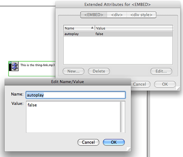

Hi Trev,
Apologies for the lateness of reply. I was hoping the Quicktime Extras
action would do this for you but it appears it only works with certain
content.
You can extend the embed tag that holds the sound with an autoplay
attribute set to false which will stop Quicktime from playing the file
on page load.
Here’s how to do this;
  1. Select the embedded sound
  2. Select Extended from the Item menu
  3. Select the Embed tag in the dialog
  4. Press the New button
    5 Enter;
    Value: false
  5. OK your way out of the nest of dialogs
  6. Test
For example:

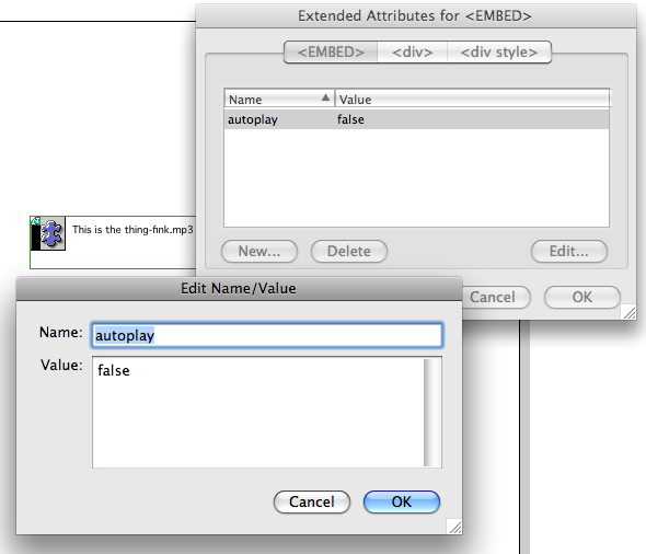

On 18 Dec 2009, at 10:46, Tim Plumb wrote:
Hi Trev,
Extras action would do this for you but it appears it only works
with certain content.
file on page load.
    5 Enter;
    Value: false
  6. Test
For example:
http://www.freewayactions.com/test/embed-autoplay/embed-autoplay.png
