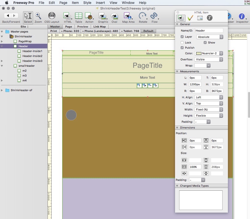

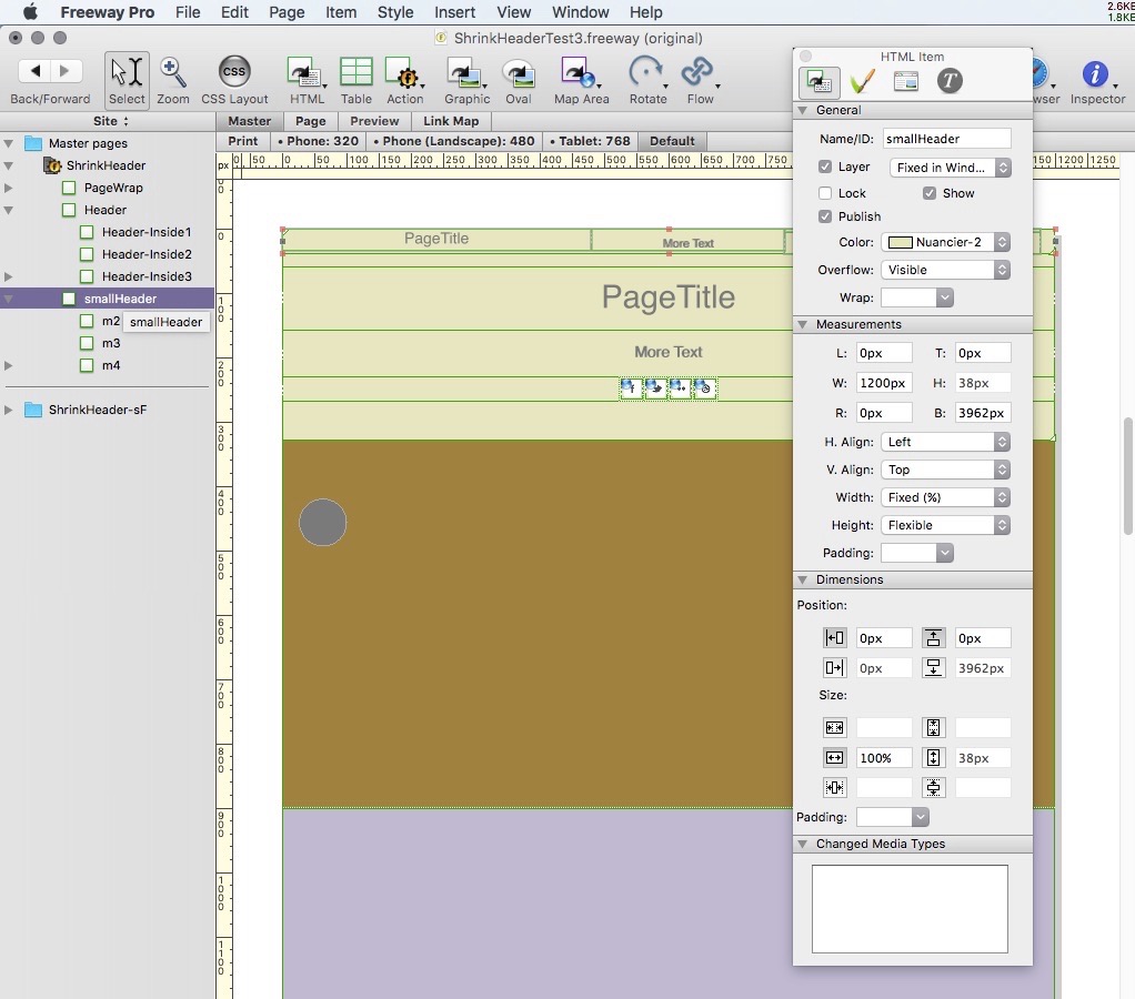

I used a simple method in Freeway, using smoke and mirrors, to collapse a large header down to a small header when scrolling. It used layers, fixed in window position and absolute position. I’m having trouble seeing how to do this in Xway. I understand that layers are not possible, but it appears that everything must be inside the page-wrapper, so I can’t place one object on top of another… or can I??
Here is a test site using Freeway, which shows the technique I would like to emulate:
TestCollapsingHeader
Here are a couple of grabs of the file in Freeway:
CollapsingHeader1
CollapsingHeader2
