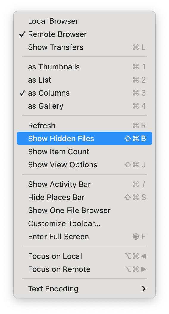

I have a theory, one that might be true, but it depends on a very specific set of options available in Transmit. Freeway, as discussed, has no way to alter the .htaccess file that I know of, and the more I think about it, the more I remember that the only way that an Action could create a file named .htaccess would be to name it something else on your Mac, and then you would need to rename it on your server with another tool like Transmit.
Here’s the relevant bits in Transmit:

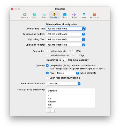

I have Ask before deleting items on. (I think that may be a default.)
htaccess is listed as a “file extension” for file transfers. I believe this lets it upload such a file, since it starts with a dot in order to make it invisible, so treating that filename as an extension is kind of a hack. I don’t believe I added this by hand.

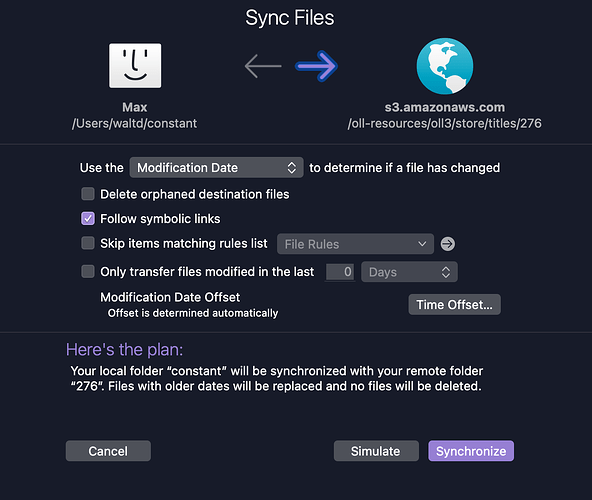

In the Sync Files overlay dialog, I leave the Delete orphaned destination files off, only ever turning it on if I really really mean it. I think when you are in this mode, it will ask you twice before doing it, but I didn’t want to test that theory in this production S3 bucket…
So my theory is that if you had that option turned on, and agreed to its warning, and also had the View / Show Hidden Files option enabled, then syncing a folder on your Mac (which very likely does not contain an .htaccess file) with a folder on your server that DID have one, might run a risk of deleting it from the destination, as it would be considered an “orphan”. I have not really tested that theory, it’s just a suspicion.
But again, if you are using Freeway to do the upload, you won’t have this issue. It never manipulates hidden files. It cannot make them, either.
