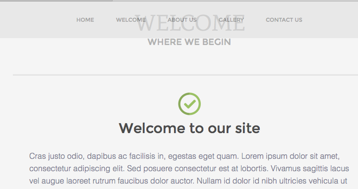

I’m using the Esperanto template and when I click on a menu item, to navigate down the page, the CSS menu overlaps the content/title.
It is using Anchors (which I haven’t used before). I can’t see how to adjust these so that the page ‘jumps’ to the anchor, but leaves it clear of the CSS menu at the top. I can’t move the Anchors.
Can anyone tell me how to do this? (Is the template supposed to behave in this way?)

Normally links to anchor points will jump to the specified point on the page but the template contains a JavaScript function that replaces this with a smooth scroll. As well as the smooth scrolling it adjusts the scroll so that the page stops 100 pixels above the desired anchor. Looking at your screen shot it looks like there isn’t enough room above the ‘welcome’ header for the script to scroll to. If you look at the Esperanto template there should be a div called ‘TopSpacer1’ which looks like it may have been removed or unpublished on your site. Add it back in and it should be OK.
