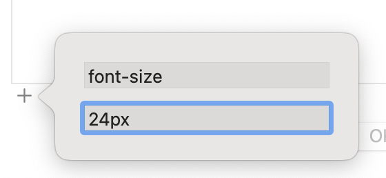

BY THE WAY, the info boxes that open with Media Styles remain permanent on my desktop. They stay even after tapping Cancel or OK. I can only remove them if I close and reopen Xway. Appears to be a bug.
It disappears for me when I click outside it or press Escape (Cancel) or Return (OK), but it doesn’t disappear if I press Return without entering a valid value - is that what you’re seeing?
[The same popup is used for extended HTML attributes, and extended properties: I think it should probably beep if you press Return without entering a valid value, as happens with other text fields. I’ll look into that.]

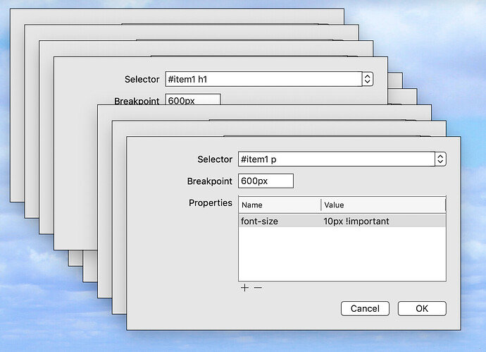

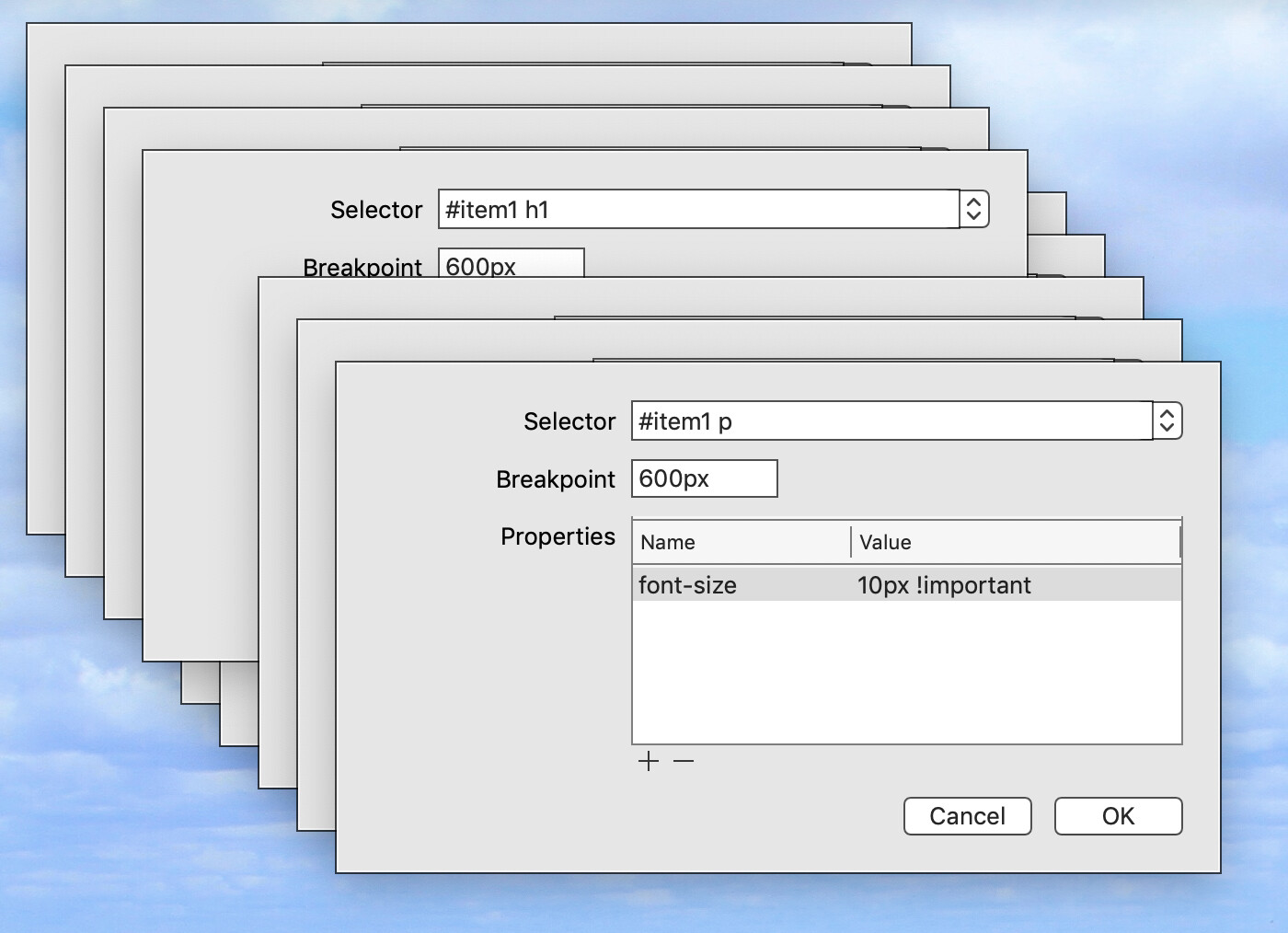

I have tried and failed several times to shrink the title heading in my Xway pages. I have tried the method that works successfully in reducing font size in Exhibeo files as well as trying to carefully follow instructions for media styles in the Xway user guide. I don’t understand what I’m doing wrong.
Also I have attached screenshots of some of the many pop-ups that remained fixed on my monitor until I close Xway.
I’ll get back to you later, but your screenshot looks very strange. Do you have this with any other Xway dialogs? What version of macOS are you running?
