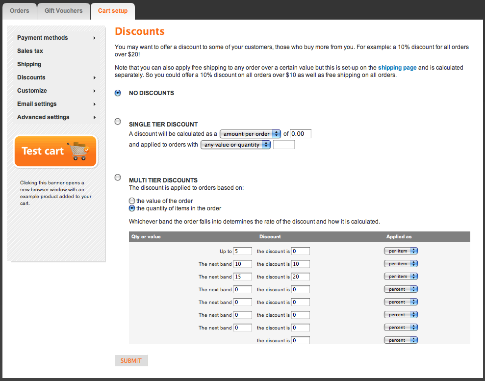

Here’s a screen shot of the Mals admin area showing how I would set up
discounts for those t-shirts;
The good news is that you can do this with the e-Buy actions as long
as you are happy to give a discount over the entire store. This
discount scheme works for the whole cart so if you wanted to offer
discounts for prints but not cards then you’d be out of luck. Judging
by your e-mail it appears that this should do the trick for you.
