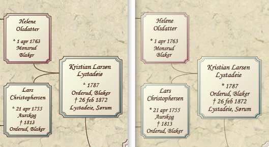

Unfortunately, I cannot use PDF, because the image quality gets very bad when exporting the image as PDF.
TIFF is the same.
I can use BMP and PNG format and keep the resolution.
I did save it in both these formats and opened it in Photoshop, but I only get one page printed there as well. I guess it is possible in Photoshop, but I am not an expert
Of course it looks poor, you are showing me a low resolution (compressed) jpeg! A vector is completely different. Even a 600 dpi png or tiff would be a vast improvement.
Have you tried printing from tiler or increased intaglio’s default output resolution yet?

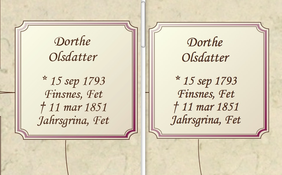

Yes, this is a jpg, but it does show the difference between the 2 formats. I did change the resolution to 600 dpi. I have not tried to print from a tiler. I use art paper and it is quite expensive, so I might have to reformat an example to fit in ordinary A3 paper.
As I said before, I did try to print the pdf and I can assure you that it is not my imagination that makes it look poorly
I would be happy to send you a part of my image in Intaglio format, if you want to look at it ‘live’. Maybe there are some setting that need to be changed ?

@ Litta. There are few reasons possible for this varieties; mix of CYMK+RGB colors or transparent colors that don´t translate well to PDF. At least there shouldn´t be any noticeable difference. To your printing question. What do want to receive at the end? I mean you have to glue it together no? There´s no LED/Laser printer which prints full size of sheet paper for instance. I´d overlay a page raster to the image smaller than the default printing size and move it print-by-print to the next frame (hiding it of course) and cut all sheets in the end for assembly - no?
