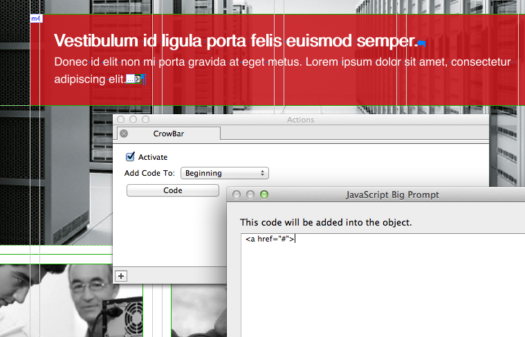

Hi Dave, tnx for the input. Unfortunately for some reason this doesn’t seem to work for me, no idea why.
However, when using the Crowbar action -applied to the DIV- it seems to work … but not quite. The link works, all text in the DIV responds, but because the Crowbar action only lets you insert code at one position (only before OR at the end of the selected element), I can’t close the link via the < /a > tag using the same action. Would be nice if the Crowbar action let’s me insert code BEFORE as well as AFTER the selected element.
But … when I insert a markup element at the end of the text, inserting the closing tag < /a > it does work, bit of a workaround due to the limitations of Crowbar.

Here a screenshot of the Crowbar action where the link opening tag is applied to the DIV. Notice the inserted markup at the end of the content where the tag is closed …

NOTE :
I was trying to solve this via the TagWrap action, which worked. But because the link tags open and close outside the DIV, you’ll loose the in the inspector applied DIV specific link style(s).
The solution was quit simple though, you’ll need to apply the desired link styles to the parent DIV (first screenshot), and remove the styles from the DIV the TagWrap action is applied to (second screenshot). Works perfectly.
