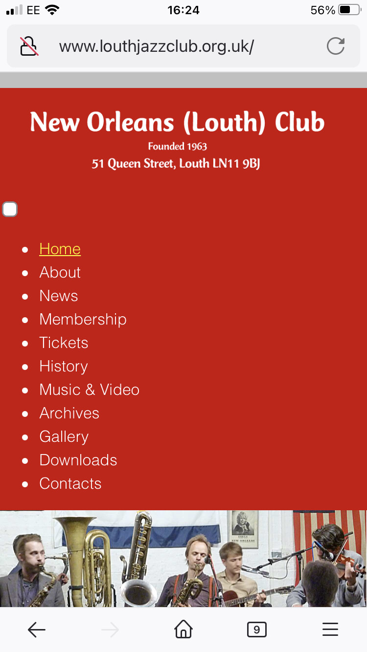

I’ve just finished adding the new menus to my fourth site. All have the same stile and the first three work fine, however www.louthjazzclub.org.uk behaves differently in that the hamburger menu is permanently expanded, even on a 21" screen where it isn’t necessary.
It’s worth noting that when I interchange menus from one site to another on a test page, faulty Jazz menus behave correctly elsewhere, and ‘correct’ menus pick up the fault on the Jazz website.

Your screenshots show that there is a missing CSS file. The way that this menu is displayed is what happens when a menu (which is a list in HTML) is displayed without CSS styling.
Check that you have uploaded everything that is in your Site folder. The simplest way to do this is to use a third-party app (Cyberduck, Transmit etc.) to synchronise the local Site folder with your online Site folder. Most upload apps have a Synchronize function (e.g. File/Synchronize… in Cyberduck).
CSS files for menus are in a css subfolder within your Site folder.
Thanks Jeremy. I should h ave remembered that!
Geoff
That appearance means that either the style sheet or the script for the menu isn’t loading. This can often be because it didn’t get uploaded to the server along with the rest of the files. That’s where I’d start looking. If you used your SFTP application to “synchronize” the site files, try uploading everything indiscriminately, overwriting everything on the server.
