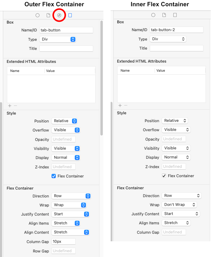

I’m developing a page with clickable buttons and doing that by putting boxes inside a flex container. I note that the outer flex container can have a link associated with it - because the “Link Inspector” option is shown at the top of the right inspector panel (see it circled in red below in the screenshot), and I could link that flex container to something if I wanted to (but I don’t - Link Type is set to None).
What’s got me puzzled though is if I put another box inside the Flex Container, and turn it into a Flex Container by ticking said box under “Style” - it does not have the option to add a link, and I would like to add one. But there’s no Link Inspector available. See screenshot as to the difference.
I have read a number of sections in the Xway manual - it says on p.179 that “Xway does not allow you to attach a link to a box that is a flex item” even though my top-level flex container clearly could have a link added to it if I wanted to add one. So I’m confused.

Regarding “Xway does not allow you to attach a link to a box that is a flex item” my thinking was the inner box is no longer a “flex item” because I checked the box called “flex container” (see earlier screenshot) :thinking:. Is that not correct?
So to me it looked like there was an inconsistency - the outer flex container could have a link attached without apparently causing any issues. But the inner flex container could not, despite having the “flex container” checkbox ticked to turn the box into one.
