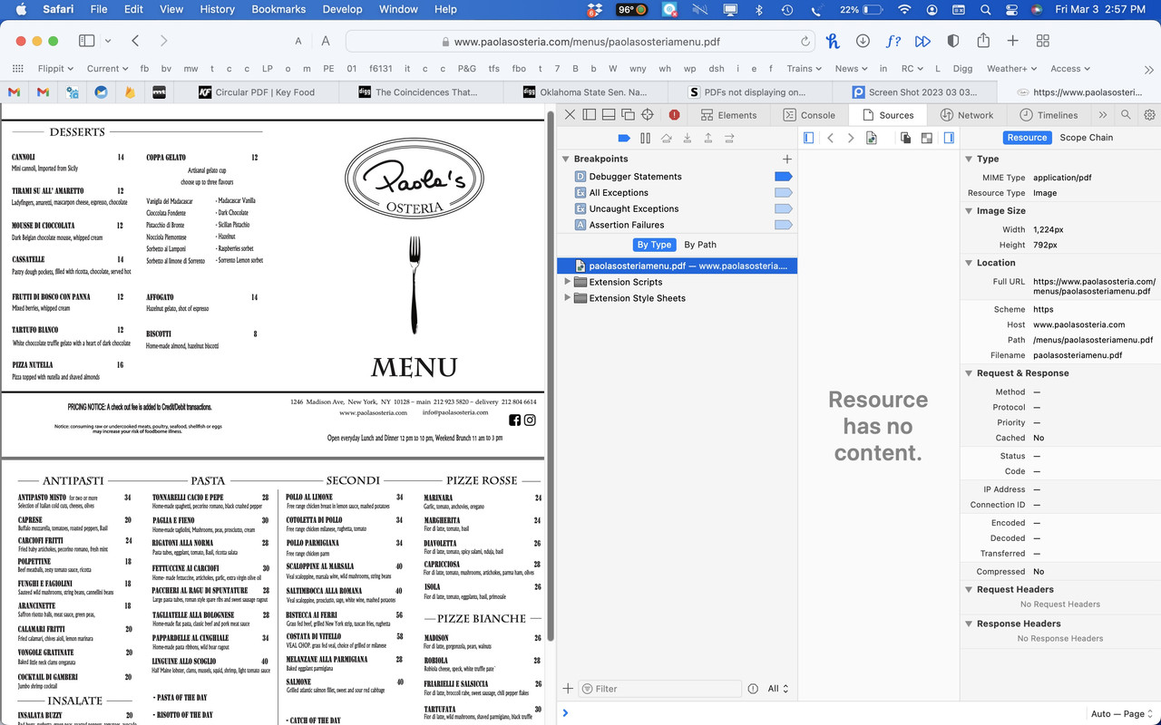

Hm. Not seeing anything. This is what I see:

Can I somehow manually add a request header? No idea how I’d do that. Page > Markup won’t work as it’s a reference to an uploaded PDF file.
Here’s what I see if I click on that link, open the inspector, then refresh once:
The Content-type header is correct. You can’t do anything in the HTML to affect the Content-disposition, though. That’s entirely up to the server (Apache) to do.
