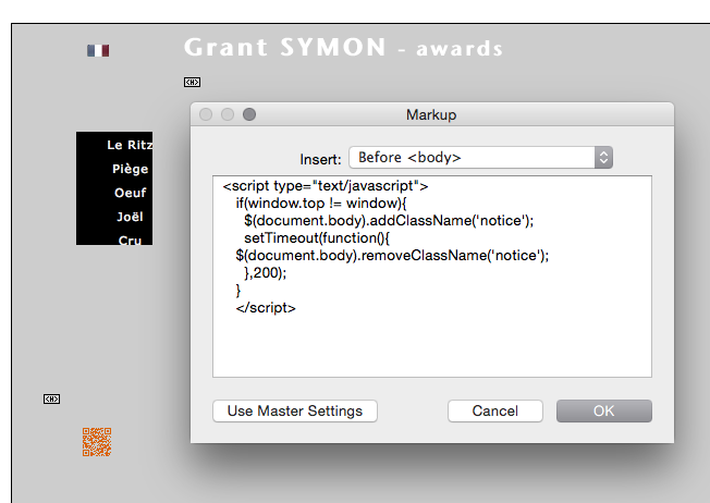

If you have control over the page that loads into that frame, then you can do this. But if it’s not your page, you can’t. Let me know if you want the JavaScript to do this.

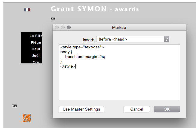

Close. That will give you a class-based style all right, but it won’t publish it unless you apply it to something. I would recommend that you put the style name in the Tag field, preceded by a dot. That will be a “tag-only” style, which gets published whether you apply it to something or not. So the long directions are as follows:
In the New Style dialog from the Styles palette, enter .notice in the Tag field.
Tab into the Name field, delete whatever is there, and press tab again.
In the Extended interface, press New.
In the Name field, enter margin-top
In the Value field, enter -20px
Okay out of the stack of dialogs.
You now have a class-based style named notice, this style does not need to be applied to anything manually, and it can be relied on to “shake” the page inside the iframe when it is rapidly applied and removed by the script.

All of this code (style and JavaScript) must go in the page that loads into the iframe, not the outer page that contains the iframe. An iframe, like any other frame, is its own sandbox, and you cannot influence the behavior or style of its content page from outside of the content page. I’ll post an example that shows this working when I get a chance.
