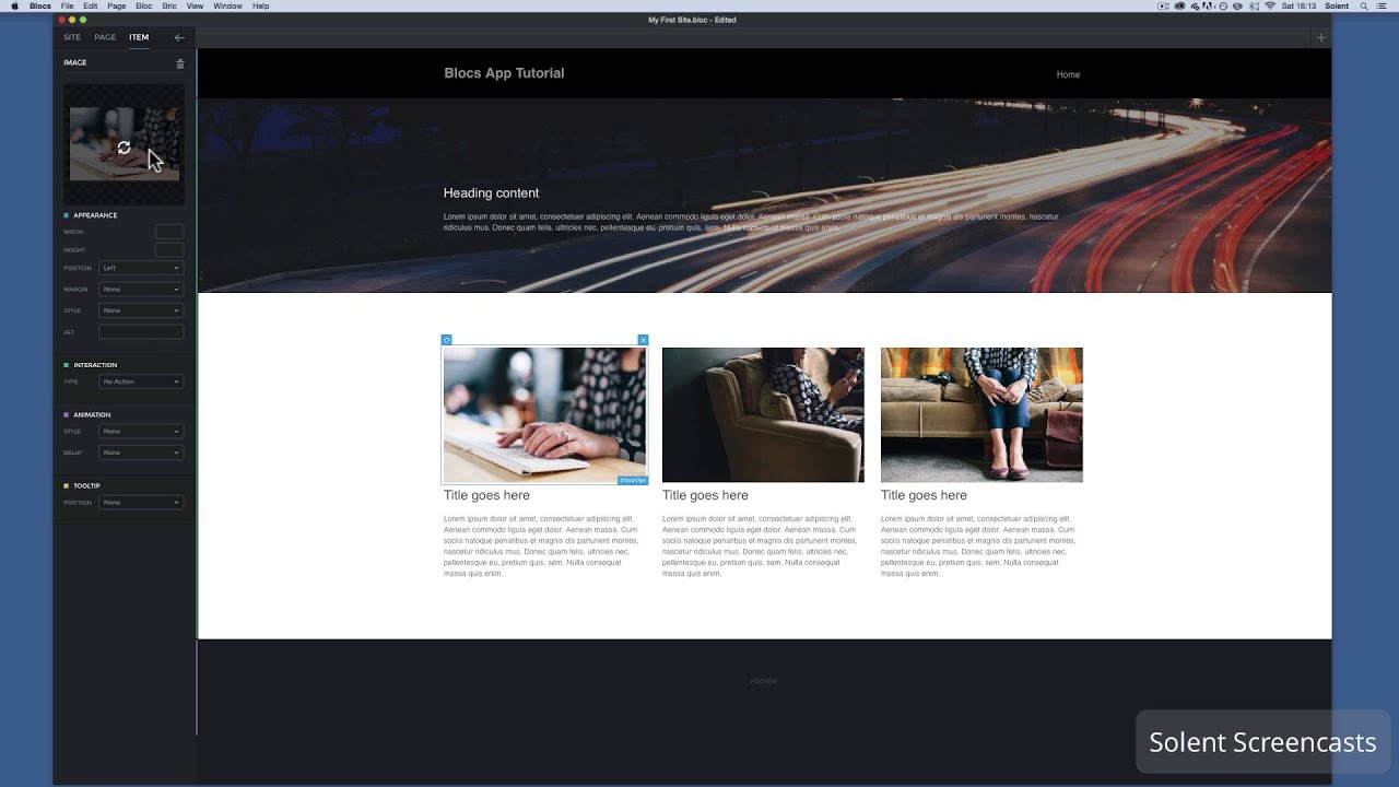

Last night I was reading the following Macworld review of Blocs 2:
Toward the end, the article mentions the caveat that PDFs cannot be added within Blocs, and that the workaround is to upload the PDFs separately, then manually type in the links to the PDFs within Blocs. I assume this is something that will be addressed in a future version?
The article also mentions the lack of a built-in FTP uploader (which is something Freeway has). Being rather adept at using the FTP client Transmit I don’t see the lack of a built-in FTP client in Blocs a show-stopper, but I must admit that for some users having built-in FTP uploading would be a significant plus.

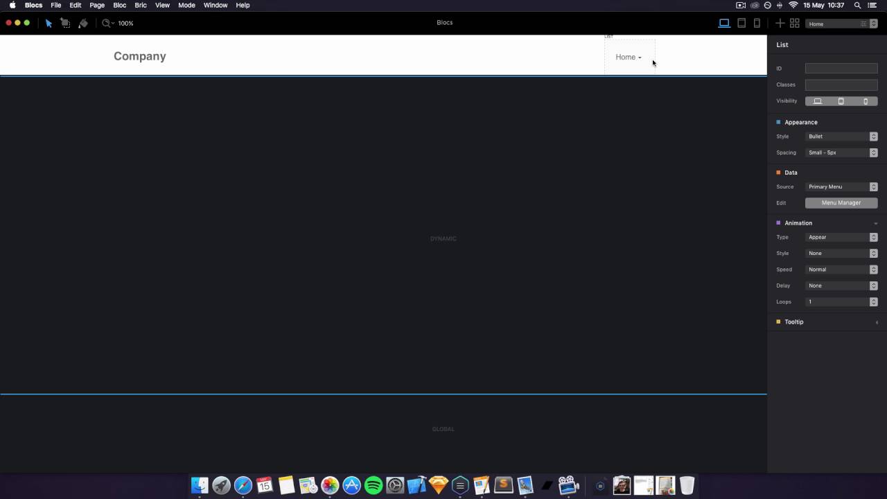

I found a YouTube video that shows how to create a basic navigation bar with drop-down menus here:
But is it possible to use Blocs 2 to create more complex drop downs that have many links in a multi-column format? For example, have a look at the following site and click on the “ALL” menu to see and example of what I mean (that example has 10 columns of links):

@JDW Blocs has a feature called menu manager, this lets you create menus, you can read more here: Menu Manager – Blocs – User Documents
Menu manager lets you create nested menus within menus, if I’m correct in thinking this is what you want to achieve.
