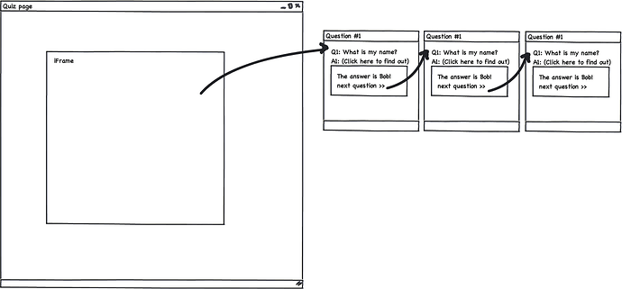

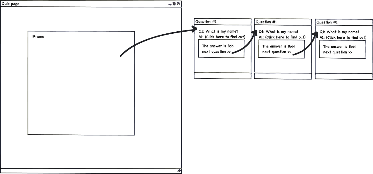

Hi Bill,
I can think of one way to do this using the current actions available
to Freeway.
He’s the basic concept;
Download the iFrame action and add it to your quiz page;
http://actionsforge.com/actions/view/99-iframe
Create a page for each of your questions and using the iFrame action
link the first page to the quiz page. On each of the question pages
use the Transition FX action to add a panel that, when clicked on,
will reveal the answer to the question and the link to the next
question. Because the questions are all contained within the iFrame
the user will appear to stay on the quiz page as they progress through
the questions.
