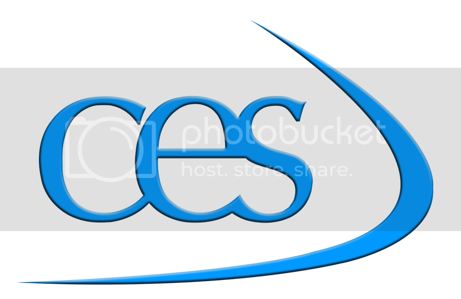

I am having a very frustrating time getting my logo to work on a page (my first one) I’m trying to build in Freeway pro 5.5. The image can be seen here:
I can successfully upload it to photo bucket, and it looks okay.
When I put it in the freeway page builder, it also looks okay.

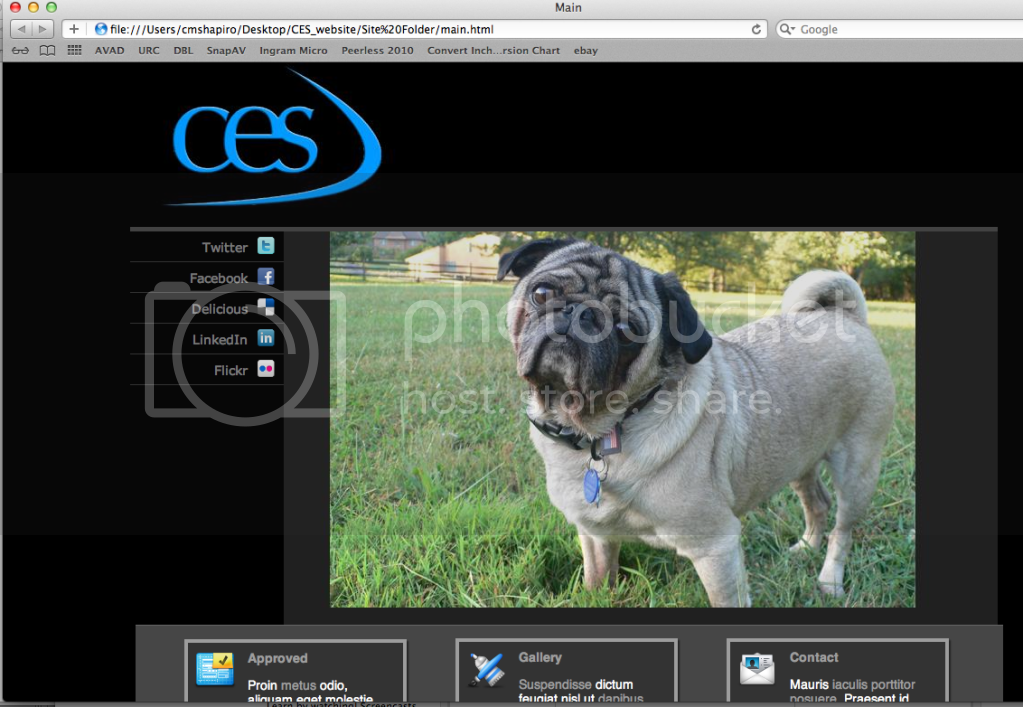

When I go to Preview mode, or launch it in the browser, it looks terrible! I have a screenshot link here (i am totally just trying to learn the software, so my page is really just a jumbled mess of experimenting):
The logo is fuzzy, and blurry. I am using web safe colors, and “saving for web” in photoshop to get a good balance of size and quality, and you can see by the first link that the exact same file inserted in Freeway Pro looks geat when its just uploaded straight to photobucket.
Does anyone have any suggestions on what Im doing wrong?

If you have “Saved for Web” in PS then use your image as a Pass-through in FW. When you import there is an option down the bottom left of the dialogue box, check it, but your image will need to be the correct size in PS as you wont be able to alter it in FW.
Dont drag/drop onto the FW page.
