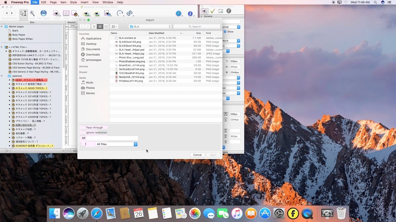

I grew weary of waiting for everyone else to update to Sierra and test so I installed Sierra (latest version as of today) on an external HDD and tested. Here’s my screencast with no sound, showing the problems in the lower left corner of the Save As and Import dialogs:
Stretching the Import Dialog horizontally brings the hidden text into view. But there is no simple fix for the missing text in the Save As dialog.
And although I had my 5K iMac’s display set to 1920x1080 to make that video, I changed it back to the 5K default and tested again to see the exact same problems in those two dialogs. I didn’t see any other major problems though.

Thanks for that James, that shows the issue 2) I reported on in the first post and that we’ve been discussing here.

Thanks James W. The video taught me two things about the file/image
import issue (and thus,
  1. I have a workaround suggestion for the file import issue …
  2. The bug is, to a certain degreee, present in OSX El Capitan too.
https://youtu.be/b60UCZjs8aA
dialog.
I meant to be more modest: I wonder if I have a workaround. Please
test.
leif halvard silli

Okay, everyone, I’ve updated my 5K iMac’s internal 1TB SSD to Sierra and am now testing Freeway Pro 7.1.3. Unsurprisingly, everything is the same as my test (see my YouTube video in an earlier post).
I agree that pressing SPACE with a checkbox selected does not toggle. But I’ve never done that before so it’s no loss to me.
I have zero issues selecting files. I click once on a file to select it ad hit return to grab it. So easy and simple. No problem at all. So although I can choose COLUMN view, why should I? It does absolutely nothing for me.
I can use my wireless bluetooth Apple mouse to check or uncheck the checkboxes in the Import Dialog just fine. It’s just that I may need to stretch the window horizontally to bring them into view. I showed that in my YouTube video.
In the Save As dialog, the two icons are gone, and the leftmost radio button is selected by default. So long as we can remember that is the default, I guess it’s not a big issue.
